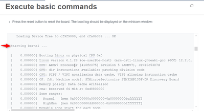

I was trying to build Linux kernel and push into my STM32MP135F-DK. For this, I was following the steps below link (Modify, rebuild and reload the Linux® kernel):
Nothing seemed wrong to me until "5.4. Reboot the board" step. After I rebooted the board, only the ST logo appears for a while, then it disappears and a black screen appears for a few seconds, then the ST logo appears again. This loop continues constantly and never switches to other screens (Linux splash screen, Weston desktop, GTK demo launcher).
I have no idea why I experienced such a thing since everything seemed correct until the reboot step. I wondered if I had pushed the wrong device tree in the "5.2. Push the device tree into the board" step in the link above (since I was using STM32MP135F-DK, I pushed the stm32mp135f-dk.dtb one). But I am not sure.

When we compare the traces with the below one (which I took from "Execute basic commands" page), things are different starting from "Starting kernel ..." section:
But I still don't understand what caused this problem, since I did everything according to the "Modify, rebuild and reload the Linux® kernel" page.
