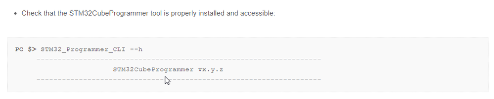

Normally if you followed the page “Populate the target and boot the image�?, you should have added the path of CubeProgrammer into your path:
Add the STM32CubeProgrammer binary path to your PATH environment variable:
export PATH=$HOME/STM32MPU_workspace/STM32MPU-Tools/STM32CubeProgrammer-x.y.z/bin:$PATHIn your case you must replace x.y.z by 2.9.0.
This binary STM32_Programmer_CLI is available in your STM32CubeProgrammer folder:
/home/osboxes/STM32MPU_workspace/STM32MPU-Tools/STM32CubeProgrammer-2.9.0/bin/STM32_Programmer_CLIAs explained in: https://wiki.st.com/stm32mpu/wiki/Getting_started/STM32MP1_boards/STM32MP157x-DK2/Let%27s_start/Populate_the_target_and_boot_the_image#Overview
So please, can you modify your path as explained here and try again the command that I sent before.
