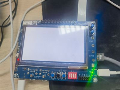

I got similar issue when using Starter package on STM32MP135F-DK
after booting normally and run following script to install demo package?
apt-get install packagegroup-x-linux-ai
systemctl restart weston-graphical-session.service
and I still get white LCD display shows, instead of some demo in https://wiki.st.com/stm32mpu/wiki/X-LINUX-AI_Starter_package
and here i got some red log in dmesg, but I could figure it out why

2024-07-02 8:57 PM
Thanks for relpy @Olivier GALLIEN !
I'm new to this board and just bought it, could you hint me how to test my screen using another cmd or some easy way?I'm not sure it‘s working but since I just bought it and I only seen it's become full light just like the image I post
2024-07-05 2:51 AM
Hi @ChrisCrossCrash ,
If the screen doesn't work properly with Starter Package out of the box it's likely and HW issue. Contact your board provider.
Olivier
