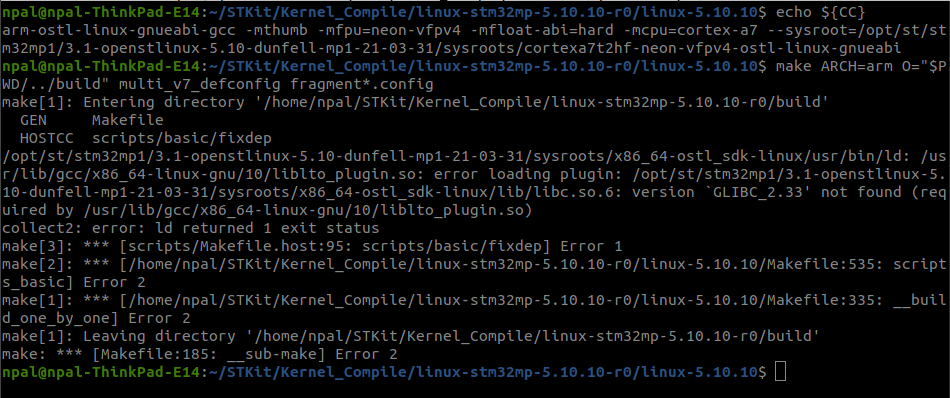

/opt/st/stm32mp1/3.1-openstlinux-5.10-dunfell-mp1-21-03-31/sysroots/x86_64-ostl_sdk-linux/lib/libc.so.6: version `GLIBC_2.33' not found (required by /usr/lib/gcc/x86_64-linux-gnu/10/liblto_plugin.so)post that came across workshop video which does it in few steps.

It fails at step : make ARCH=arm O="$PWD/../build" multi_v7_defconfig fragment*.config
Kindly help me out.

It seems to me your gcc installation is based on gcc-10.x (from your screen snapshot, I read /usr/lib/gcc/x86_64-linux/10).
On the two supported platforms for OpenSTLinux, for Ubuntu18, the default gcc is 7.x and for Ubuntu20, the default gcc is 9.x.
Does the installed and used gcc version on your machine be the cause of your problem because too high compared with 7.x or 9.x?

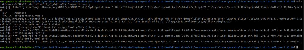

Hi @Jean-Marc B : Thanks for pointing that out. I removed all other version of GCC to make sure it does not conflicts with the one i need and installed 9.x version. However i am still getting this build error.
