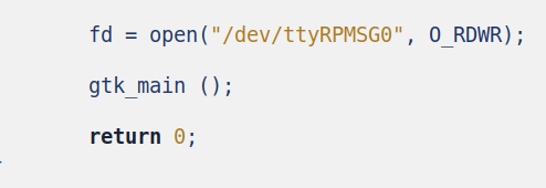

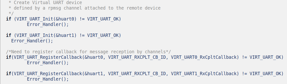

Virtual UART is created in Cortex-M4 project, in the main.c file.
Then, in Cortex-M7 project you can find the connection from A7 processor to the Virtual UART created before from M4 processor:

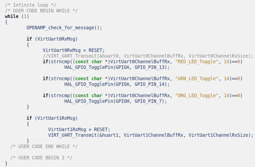

The full application aims to build a user interface on the LCD touch screen via GtkBuilder on Cortex-A7.
Then you'll obtain three graphic buttons that, once pressed, send a message through IPCC to the Cortex-M4.
This one receives the message, decode it and toggles the related LED:
Please note that in this project first the Cortex-M4 has to create the virtual UART and then the Cortex-A7 can connect to this UART.
