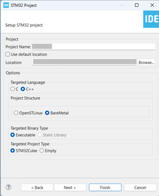

And STM32Cube doesn't think Azure is an option:

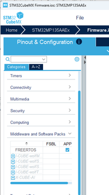

CubeMX doesn't think Azure is an option:
