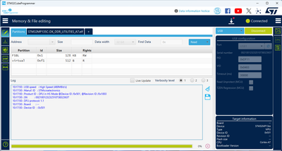

Maybe there's another problem with this board ... it looks like BOOT0 is pulled low and BOOT1 and BOOT2 are pulled high which should mean serial boot mode, but what I'm seeing in STM32CubeProgrammer is this:
ChatGPT says I should be seeing STM32CubeProgrammer downloading a small loader into the system's RAM automatically, something like this:
Downloading built-in loader...
Loader successfully executed.and that since I'm seeing DFU mode, that indicates my STM32 isn't actually in serial boot mode. Is it right?

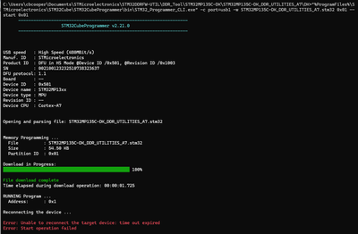

could you try following (I did not tested on MP13-DK, but work on my MP15-DK board).
"%ProgramFiles%\STMicroelectronics\STM32Cube\STM32CubeProgrammer\bin\STM32_Programmer_CLI.exe" -c port=usb1 -w STM32MP135C-DK_DDR_UTILITIES_A7.stm32 0x01 --start 0x01
You should then being able to see prompt on the console like https://github.com/STMicroelectronics/STM32DDRFW-UTIL/blob/main/README.md#2312-command-examples
If not, need to debug your HW (and SW), but would be hard without JTAG/SWD).
SW might need to be recompiled if your board does not use exactly same HW setup than STM32MP135C-DK board (mostly UART port, I2C pins for STPMIC1, power supplies for DDR)

2025-12-16 8:27 AM
Alas no UART, only USB. PD6 goes to RMII_REFCK and PD8 is not connected at all.
Running your command line on an un-modified STM32MP135C-DK_DDR_UTILITIES_A7.stm32 seemed to do something at least:
