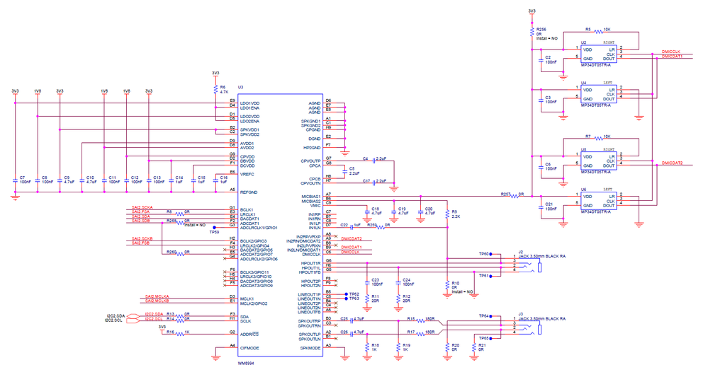

i'm having an issue with STM32MP157c and audio driver WM8994 (same as used into STM32MP15-DK).
At boot time i'm still have the following error:
[ 4.250237] ALSA device list:
[ 4.251761] No soundcards found.
I share the electrical drawing of our custom board and my custom DTS.
I followed the steps described here:
https://wiki.st.com/stm32mpu/wiki/Soundcard_configuration#References
but i'm still get the same error.
Kind regards
Ilie

Yes, you're right, WM8994 is used into EV1 but in my custom board i don't have all of the other interfaces mentioned here at chap.2.1:
Your solution is the first way i done (tha same as indicated at the link upward), I also tried to remove &sai4a_port, &spdifrx_port, &dfsdm0_port, &dfsdm1_port, &dfsdm2_port, &dfsdm3_port because I didn't have these interfaces on my custom board but it didn't help at all.
Can you please provide the complete dts settings of EV1 board, please?
Regards
