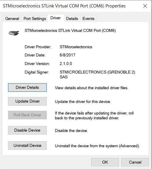

2021-01-11 6:51 AM
Looks like it's version 2.1.0:
Not sure if this is the best way to check, or if there's a good way to upgrade. Any advice here would be helpful.
Thanks.
-Mike
2021-01-13 5:47 AM
Hi @MWors.1 ,
Sorry I thought i have reply but I should have forget to click on "reply" or else :\
I meant ST-Link firmware version on target.
With STM32CubeProg once connected with ST-Link you might see firmware version and firmware upgrade button
Olivier
