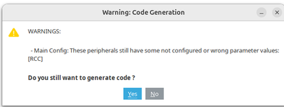

I believe there's something wrong with RIF configuration, but I have no clue what. The story behind this is that I created CubeMX project selecting STM32MP257F-EV1 board and initialized all peripherals to their defaults, and started moving and removing unneeded peripherals one by one (my custom board is very similar to EV1, hence the decision to select EV1 board as starting point).

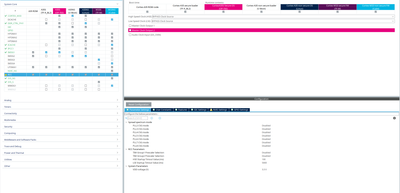

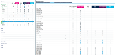

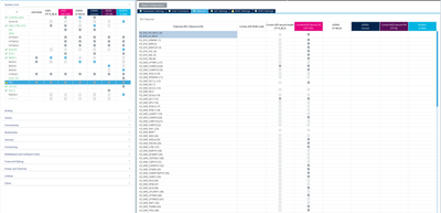

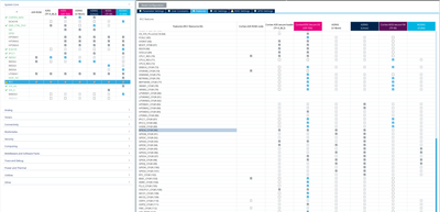

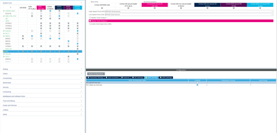

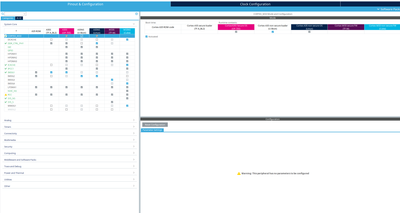

When I click Generate Code in CubeMX for this project I do get RCC warning:
Here are all the RCC settings:
Is it even possible to only run A35 without M33 at all?

Hello @rossU,
Yes, it's posible to only run A35 without M33 at all : feel free to compare the Op-tee DT configuration generated by CubeMx and the default one coming with STM32MP257F-EV board: be sure that the differences are relevant with what you modified in CubeMx.
