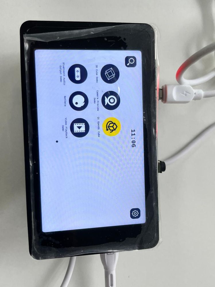

you can see qt cube
openstlinux distribution with qt layer , you can see my qt version

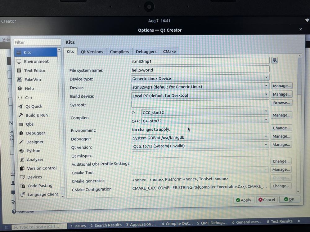

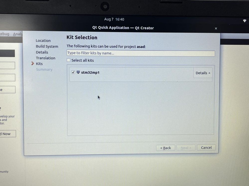

please check the settings, gcc , g++ ,and qmake i added from build directory
in this i select the STm32, but the next option not available

Hello @asadullah4571,
In your kit window, I see "Qt version" item as "invalid".
Could you please go to the Kits -> "Qt Versions" panel and check the "qmake Path" set in the tool is correct.
It should point to qmake SDK tool. Something like:
<Your PC Install path >/SDK/sysroots/x86_64-ostl_sdk-linux/usr/bin/qmake

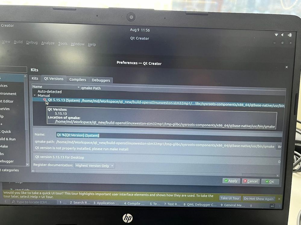

2024-08-08 9:16 PM
hello @PPAGE.13
in your SDK package i did not find any qmake.
home/md/SDK/sysroots/x86_64-ostl_sdk-linux/usr/bin/.
i found only cmake. why ?
let me clarify a bit more:
- For Developer Package: the standard SDK you can download from st.com does not contain any Qt features like qmake.
This is integrated inside X-LINUX-QT SDK add-on. For mp1, this is not today available (only mp2).
When you install the X-LINUX-QT SDK add_on, Qt creator will be configured automatically.
- For Distribution package (your case), you need to generate your own SDK after having compile your image with Qt feature.
Please refer to our wiki page for all related to SDK generation: https://wiki.st.com/stm32mpu/wiki/How_to_create_an_SDK_for_OpenSTLinux_distribution
bitbake st-image-qt
bitbake st-image-qt -c populate_sdk
Then install the SDK: execute "xxx.sh" script available in: build-openstlinuxweston-stm32mp15-disco/tmp-glibc/deploy/sdk
The installed SDK will contain Qt features (libs, qmake, ...), please use it to configure manually Qt creator.
