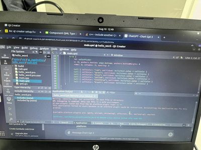

hi @PPAGE.13
please help me out this, it is showing warning.
and i run the hello world application(Hello_World) without sudo it is working but , when i use the application with sudo it will give the error as like a warning.
2024-08-20 3:54 AM
please go to following chapter for more details
"9.6. Configure the STM3 MPU Kit" in
https://wiki.st.com/stm32mpu/wiki/X-LINUX-QT_Expansion_Package
To summarize: the 2 variables below must be set in Qt Creator "Run" Qt configuration when you launch test from the host:
XDG_RUNTIME_DIR=/run/user/1000 QT_QPA_PLATFORM=wayland
When you execute the test from the target, these variables are already set by default.
BR,
Philippe.
