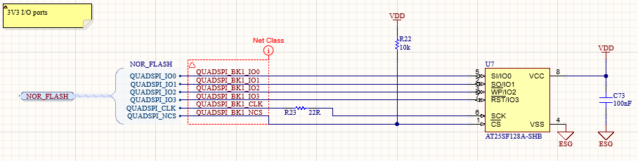

I cannot get the QSPI NOR-Flash to work on my custom board using an STM32MP153CA + Adesto AT25SF128 NOR flash in U-BOOT. I'm working with 5-10-dunfell-mp1-21-11-17 files included on the 3.1.0 ecosystem.
The schematic section is shown below:
Is not that different from the STM32157-ev1 implementation.

Command failed, result=1I connected the scope to the QSPI lines and got the following replies:
0x9f -> 0x1f 89 01 1f 89 01 (not sure why 6 Bytes and not 3?)
0x01 00-> 0xff
0x05-> 0x00
0x35-> 0x00
0x05-> 0x00
0x01 00 02-> 0xff ff
0x05-> 0x02
0x35-> 0x00
When checking the output from sf probe command, I noticed the SPI speed is set to 25MHz. On the QSPI node max frequency was set to 108MHz and on the defconfig to 40MHz (CONFIG_SF_DEFAULT_SPEED=40000000), so I don't know why then the clock speed was set to 25MHz.
Any idea why it's not working?
To include my NOR flash device Adesto AT25SF128A I just added the quoted line on uboot/drivers/mtd/spi-nor-ids.c, was there something else I should have done?
