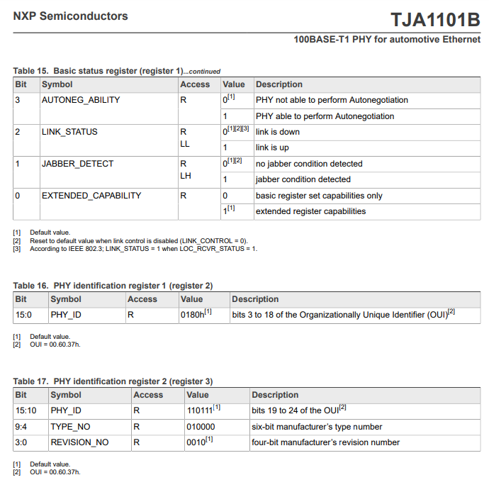

Are you sure about the ID used for your phy? In the datasheet  PHY NXP TJA1101 :
0693W00000QM4pQQAT.pngI would go for compatible = "ethernet-phy-id0180.dd02" instead ( [3:0] depending of the phy revision)
Linux side with the DV3.1, the phy driver is available:
net/phy/nxp-tja11xx.c
#define PHY_ID_TJA1100         0x0180dc40
#define PHY_ID_TJA1101         0x0180dd00
#define PHY_ID_TJA1102         0x0180dc80
2- I've enclosed a patch has been merged in DV4.0.1 to rationalize the settings and also fix the MII setup, this was due to an incorrect register muxing setup which did not follow the product Reference Manual:
Hope that will fix your issue.
