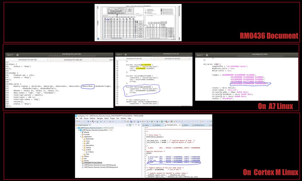

I have taken the first steps of the project and I hope to do it successfully with your help.
You know better than me the electronic circuit and the structure of stm32mp157,
I use 64 kB and three 128 kB memory in addition to DDR3 for running linux. It is so complex but I can explain it step by step if you want.
After too many ties i can access the attachment picture, Could you understand my recent status using sending image?
Could you help me?
Kind regards

Hi Mr @Community member
Thank you indeed.
I am running "production" mode and accessing DDR3 is available for me.
Im not worried a bout performance or running speed.
according to RM0436 datasheet i can access to DDR content without any problem.
i have done the following settings on Cortex-A and Cortex-M. please check attached file...
if it is hardly readable tell me to send each of them separately.
