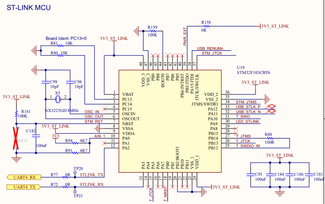

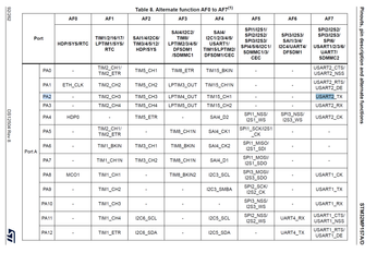

Based on the schematic of the STM32MP157F-DK2, I found out that the STLINK RX and TX is connected to PA2 and PA3 on the ST-Link MCU and it is connected to UART4 RX and TX. Based on the datasheet, I found out that the port PA2 has alternate function of USART2_TX and hence I configure the pins as shown below, assuming my ADC values can be displayed through the serial monitor when code is run. I have configure the baud rate as 115200.

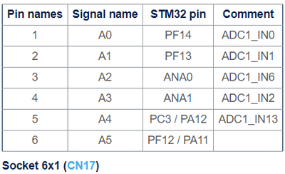

Next, I am connecting my sensor onto the STM32 discovery board on the Arduino connector pins at the bottom of the board.

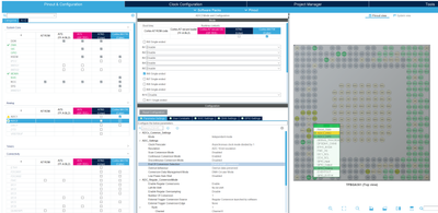

Based on the datasheet attached as image above, I connected LO + to PE11 on the STM and configure it as GPIO INPUT while connecting LO- to PE14 and configure it as GPIO INPUT as well. Next I connected AN0 to PF14 and configuring it as shown below. However, based on the datasheet, I should configure it as ADC1_IN0 but it is not shown in the pinout view so I configure it as ADC2INP6 single-ended.

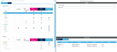

I also want the ADC the store into DMA so this is how I configure my DMA2.

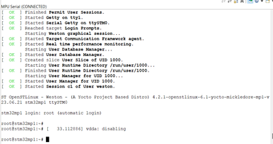

When running the code in CM4, it does not display the ADC values that I want but only load into the terminal of the Yocto OS.
