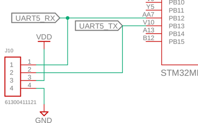

2024-12-13 5:39 AM
Thank you very much for your assistance. It appears I misinterpreted the evaluation board schematic. Could I potentially use the following UART pins to flash the SD card in DFU mode? The CubeIDE offers a UART option. Additionally, I'll explore the possibility of directly programming the SD card.

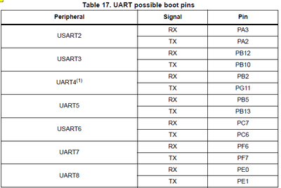

2024-12-13 5:57 AM
you could use UART only with the following pins (from AN5031, but also on wiki.st.com)
But UART is usually limited to TF-A/uBoot flashing as it will be extremely long to flash hundreds of MBytes with UART.
Best would be to program the SD-Card with PC (although it might be possible with W10/W11 using specific disk utilities, we only describe with Linux or Virtual Machine using dd).
Regards.
