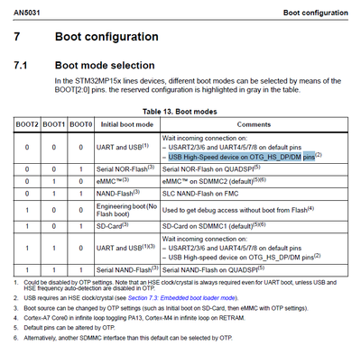

DFU is not working on OTG_FS pins, you should use OTG_HS ones.
Regards.

using EVAL or DK board is ok, but if any changes, you need to follows AN5031.
Did you use STPMIC1 ?

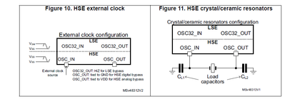

to support USB boot with HSE 25MHz, you needs to fuse OTP (this frequency is not part of auto-detection). Maybe better in a first intent to use the recommended 24MHz.

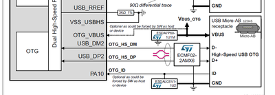

according to AN5031, only 2 wires are enough
on 18x18 LFBGA448 this is AB14 for USB_DP2 and AA14 for USB_DM2.
Apart supplies, need to have 24MHz HSE crystal or oscillator of 8, 10, 12, 14, 16, 20, 24, 32, 36, 28, 40, or 48 MHz.

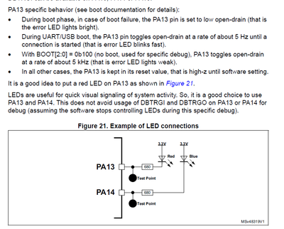

Output PA13 should be toggling at about 5Hz when in 'serial boot' mode until attached to a PC with USB or UART. need a pullup on PA13 as driven open-drain by the BootROM.

you must use USB_DP2 and USB_DM2.
could you please point us where did you find on the EVAL board ?
https://www.st.com/en/evaluation-tools/stm32mp157f-ev1.html
I see this
No USB connected on PA11/PA12 (although it support USB full-speed, it cannot be used for DFU boot)
So, the only possible option with your current board is to program the SD-Card on the PC.
