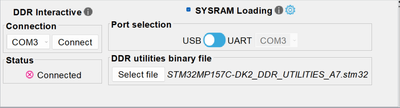

However, when trying to do the same procedure without previously running the firmware in the STM32CubeIDE, and instead using the SYSRAM Loading option, the connection fails. My procedure for this is:
Get error window:

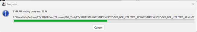

I have similarly tried SYSRAM loading with the UART option selected and with the device in Engineering Mode instead (Boot0 = 0, Boot1 = 0, Boot2 = 1). It appears that the SYSRAM loading is functional at first:
But then the same error is shown once it completes:
Is this the correct way to emulate board bring-up (specifically DDR testing)? Are there any issues with this procedure?

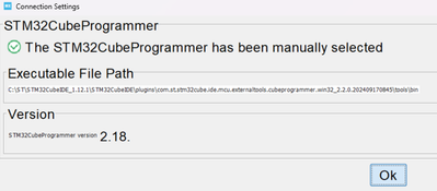

Here is some information on my development environment:
Other reference documents used:
