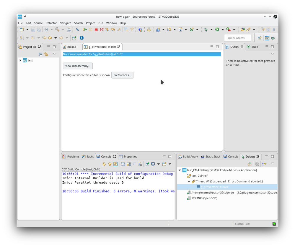

2020-07-09 2:00 AM
Messages on the CubeIDE is:
I am using ethernet via a different network, DHCP.
However for the thud build, I am using the same ethernet setup and it worked.
No source available for "g_pfnVectors() at 0x0"
It seems there were no shell commands executed on the target.

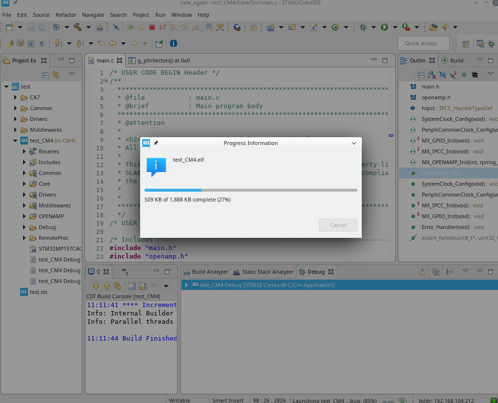

>> On the thud distribution running on the target, the "Uploading to target process indication" flops up
This is confusing me. What do you mean ?
This is the process indicator when using the the thud build on the target.
On dunfell I do not get so far. - Same network configuration, CUBEIDE was not restarted after target upload failure on the dunfell built.
