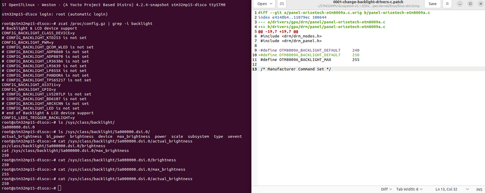

2024-07-16 1:45 AM - edited 2024-07-16 1:46 AM
Thank you @Erwan SZYMANSKI . I followed the same patching steps for panel-orisetech-otm8009a.c file
here my .bbapend and patch files in the directory of my own layer ~/STM32MPU-Ecosystem-v5.1.0/Distribution-Package/layers/meta-my-layer/recipes-kernel/linux/linux-stm32mp
nesnes@nesnes-ABRA-A5-V19-2:~/STM32MPU-Ecosystem-v5.1.0/Distribution-Package/layers/meta-my-layer$ tree
├── conf
│ └── layer.conf
├── COPYING.MIT
├── README
├── recipes-example
│ └── example
│ └── example_0.1.bb
└── recipes-kernel
└── linux
├── linux-stm32mp
│ └── 0001-change-backlight-drivers-c.patch
└── linux-stm32mp_%.bbappendFILESEXTRAPATHS:prepend := "${THISDIR}/linux-stm32mp:"
SRC_URI += "file://0001-change-backlight-drivers-c.patch" diff --git a/panel-orisetech-otm8009a.c.orig b/panel-orisetech-otm8009a.c
index e4140b4..11079ec 100644
--- a/drivers/gpu/drm/panel/panel-orisetech-otm8009a.c
+++ b/drivers/gpu/drm/panel/panel-orisetech-otm8009a.c
@@ -19,7 +19,7 @@
#include <drm/drm_modes.h>
#include <drm/drm_panel.h>
-#define OTM8009A_BACKLIGHT_DEFAULT 240
+#define OTM8009A_BACKLIGHT_DEFAULT 100
#define OTM8009A_BACKLIGHT_MAX 255

2024-07-16 5:57 AM
I did the flashing and from root ı looked at he changes and ı can see my modification. It works just the way it should be. "#define OTM8009A_BACKLIGHT_DEFAULT " changed from 240 to 250.
2024-07-16 6:00 AM
Hi @nesnes ,
Perfect! Thanx for your quick feedback.
Have a nice day,
Erwan.
