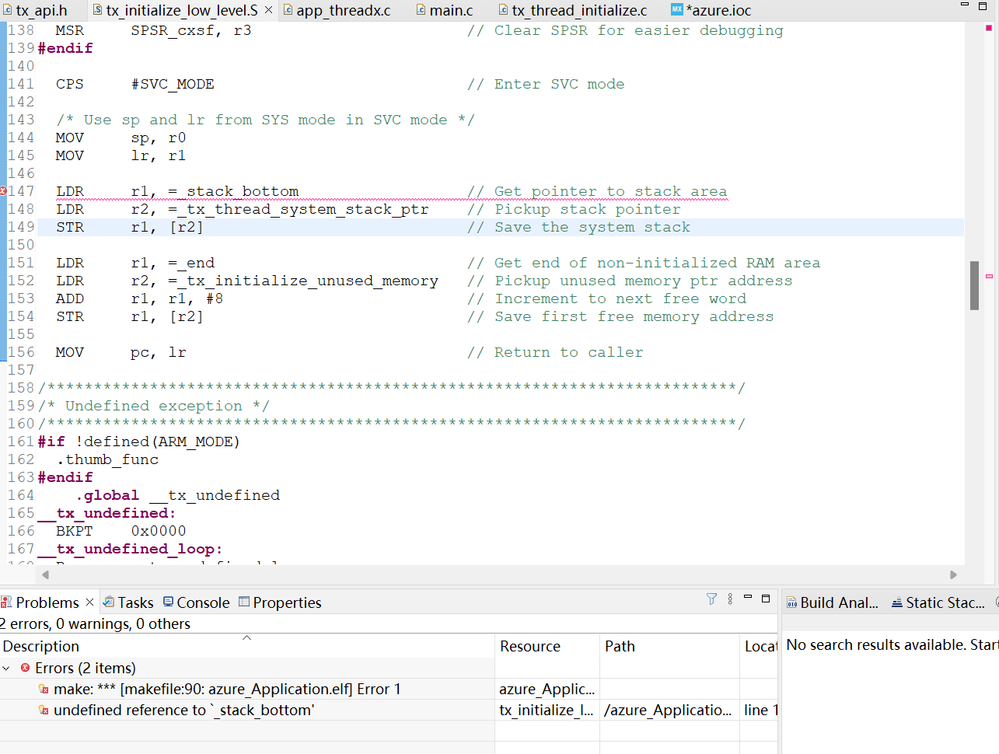

D:/ST/STM32CubeIDE/workspace_1.14.0/azure/Application/Debug/../Core/Src/tx_initialize_low_level.S:147: undefined reference to `_stack_bottom'

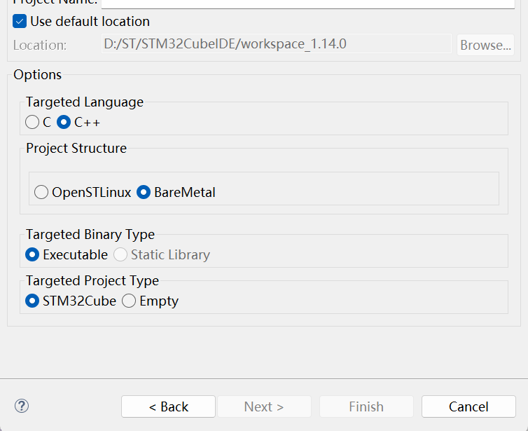

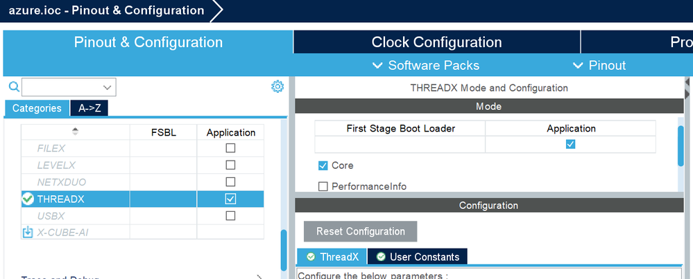

I config the project just with these simple steps, without any coding.

Hi @sunfammer ,
Actually this is know issue reported as restriction in STM32CubeMX release 6.10.0 - Release note page 19
When using the STM32CubeMP13 bare-metal firmware and activating Azure® RTOS
ThreadX, the STM32CubeIDE linker file must contain the following section to avoid
compilation issues:
.stack :
_stack_bottom = ABSOLUTE(.) ;
/* Allocate room for stack. This must be big enough for the
IRQ, FIQ, and SYS stack if nested interrupts are
enabled.*/
. = ALIGN(8) ;
. += 32768 ;
_sp = . - 16 ;
_stack_top = ABSOLUTE(.) ;
} >RAM
_end = .;
Olivier
