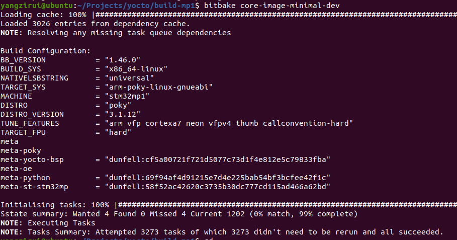

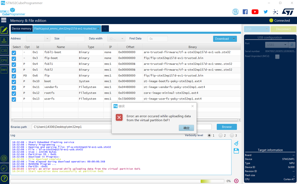

Hi, I downloaded the image file required by STM32MP157-EV1 from Yocto, but this error occurred when I used ST32CubeProgrammer. Does anyone know how to solve it?
Error:
Yocto image information:

Hi @EYANG.1 ,
Did you succeed to program the Starter Package ?
Could you provide UART log while programming ?
Thanks
Olivier
2021-12-16 7:19 AM
Hi,@Community member ,
You are right, I did not program the source code, and this is the only message in UART log when I was immigrating images. Is that the cause of problem?
And yesterday, I created a new (.dts )and (.dtsi) in /temp/work-shared/stm32mp1/tfa-source folder. But I still do not know how to update it and create a renewed image by Yocto so that I could run it at STM32 board. Do you have good idea?
Thank you
Edward
2021-12-21 4:51 AM
Hi @EYANG.1 ,
you need check tf-a device tree. The file should contain the settings of the power supply chip ST PMIC STPMIC1. example for STM32MP157A-DK1:

/* USER CODE END i2c4 */Apparently, at startup, tfa interacts with this chip, and if it is not configured, then fsbl-boot will not be able to load your image via USB.
I recommend editing the device tree that ST provides
2021-12-22 5:39 AM
Hi @EYANG.1 ,
I notice you load image for EV1 with MP157D
Which mean 800Mhz support.
Can you confirm it's the actual reference of your board ?
Thanks,
Olivier
