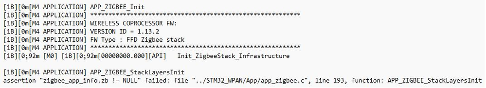

Hi, I have a small problem with the zigbee strack i hope someone could give me an direction for.
When I boot up I get an error just after it initialized the CPU2(M0).
static void APP_ZIGBEE_StackLayersInit(void)
APP_DBG("APP_ZIGBEE_StackLayersInit");
zigbee_app_info.zb = ZbInit(0U, NULL, NULL); <<<--- seems to return 0,0,0,0
However IPCC seems to work since it communicates the version nr etc.

I have tried first to make my own project, but afterwards I took an example and changed the mcu to 30CE...

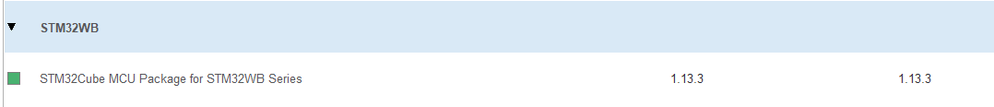

2022-07-07 6:10 AM
I think I have taken it from this path:
C:\Users\xxxxxx\STM32Cube\Repository\STM32Cube_FW_WB_V1.13.3\Projects\STM32WB_Copro_Wireless_Binaries\STM32WB3x
Same version as the package in cubeIDE...
I know see the one in the link is 1.4.0...
Do I then need to update the project also?
