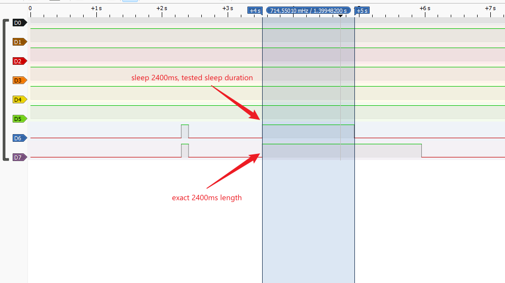

I use STM32WL RTC Alarm as low power mode timer for achieve ms level accrancy and any duration sleep. System will convert sleep time to Alarm time before enter low power mode. I have tested different sleep time, verified convertion result is correct but system will always wakeup by Alarm advance 1 second than Alarm time. below is my RTC init and Alarm Setting Code:
```c
Below is gpio reflect sleep time monitored by logic analyzer:

Hello Simon,
Could you please provide some more information about the RTC configuration, including:
Regarding your configuration for sAlarm.AlarmSubSecondMask, since you are using the Binary_Mix mode, you should use RTC_ALARMSUBSECONDBINMASK_SS31_10 from the group RTCEx_Alarm_Sub_Seconds_binary_Masks_Definitions.
Also, could you please provide the code for the function subsecond_add()?

2024-02-29 12:27 AM
Hi, Victor,
I really appreciated the information you gave me. the more relative code may address the question:
