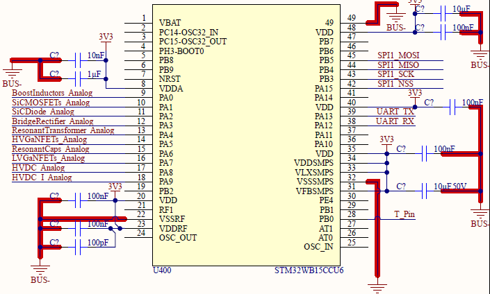

Hi team,
I used STM32WB15CCU6 in my project for Voltage and sensing. I already used all analog pin for sensing.
I need one SPI and one UART communications channels.
Can you please suggest which pins can I used for SPI and UART.
I request please share the schematic or pin mapping details.

Ok.
Can you please give me some idea which pin I can use for SPI and UART.
2022-11-30 2:57 AM
Can I use Pin 46 (TX) and Pin 47 (RX) for UART Communication.
2022-11-30 4:09 AM
I have used below configurations for SPI and UART communications.
Can you please let me this is ok or not.
For SPI
Pin42- PA15 SPI1- NSS
Pin43- PB3 SPI1- SCK
Pin44- PB4 SPI1- MISO
Pin45- PB5 SPI1- MOSI
For UART
Pin46- PB6 USART1_TX
Pin47- PB7 USART1_RX
I request please provide your opinion.
Thanks
2022-11-30 5:25 AM
Yes, you can use these pins.
