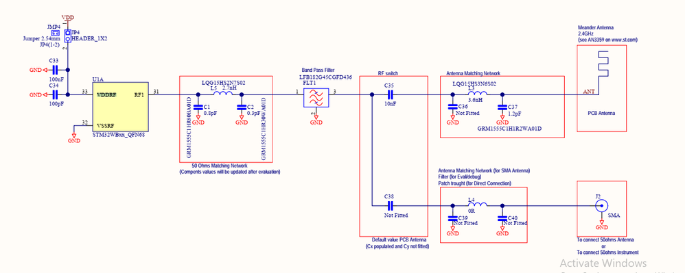

Hi Sir,
In the MB1355 schematics what is mean by 0R value. If it is 0 Henry what is the use of placing 0Henry. Does 0 Henry gives any effect??
2019-07-25 4:10 AM
Piece of wire..
Using a land footprint to make a linkable bridge, or provide a spot for a circuit adjustment to be established later.
2019-07-25 4:24 AM
Thank you for quick response
2019-07-25 5:17 AM
As a side note, "0R" means "zero Ohm". And such zero Ohm resistors are available, for this very purpose.
2019-07-26 2:39 AM
Is it zero Henry component which we can buy and solder on the board or it is just a connection between C39 and C40. If it is component how can I get the part number of it? I didn't find in the MB1355 BOM list.
2019-07-26 3:00 AM
0R is a resistor, which supposedly has 0 (zero) Henry.
Such a 0R resistor - or simply a wire - would be used to bypass the filter section for the second antenna connector.
C39 and C40 are not fitted anyway, as the schematics says.
2019-07-26 3:11 AM
That means here zero ohm resistor is connected like RC0402JR-070RL(part number of 0 ohm resitor). am I correct?
2019-08-20 8:33 AM
0R resistor is a symbolic name for a simple wire. There is no part number associated with it . This is why you cant find it in the BOM list.
