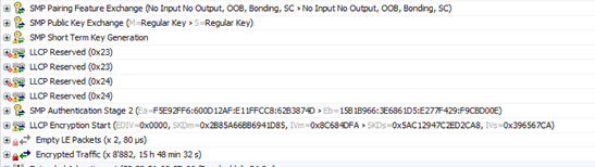

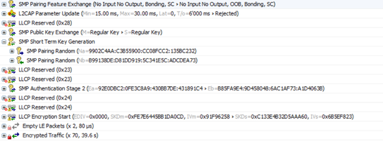

I've tested the OOB function using 2 BLE MCU WBA54,
case 1, one provide the OOB data then send to the other
case 2, both proved the OOB data then send to each other
2 cases are OK, pairing success and bonded.

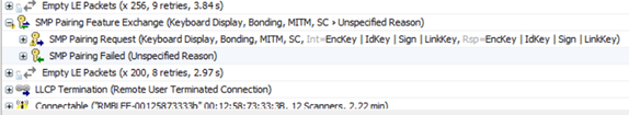

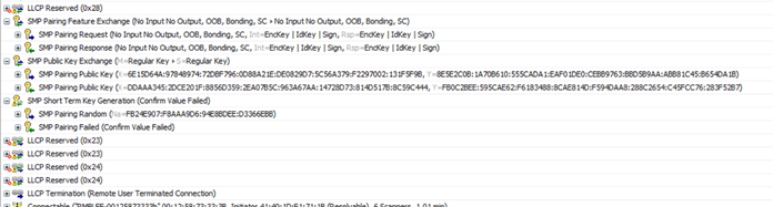

from the parameter indication, len could be 0 to indicate data are not used, so I tried to use len = 0 as input to force OOB pairing, it indeed force OOB pairing, but SMP pairing Failed with confirm value failed.
also, I've tried using
mode |= (1 << 4);
mode |= (1 << 5);
mode |= (1 << 7);
aci_hal_write_config_data(CONFIG_DATA_SMP_MODE_OFFSET, CONFIG_DATA_SMP_MODE_LEN, &mode)
to forbid the the other pairing method after OOB data was generated, but SMP will be failed with unspecified Reason
what can I do if WBA54 only provide OOB data and also force the OOB feature?
