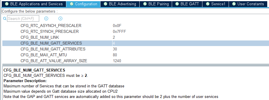

So, I think I found out what was wrong.
In the BLE configuration tab the following 4 parameters seemed to be too large for the WB15 (and WB10)
CFG_BLE_NUM_GATT_SERVICES 8
CFG_BLE_NUM_GATT_ATTRIBUTES 68
CFG_BLE_MAX_ATT_MTU 156
CFG_BLE_ATT_VALUE_ARRAY_SIZE 1344If I set them to the below values it seems to work just fine. I have no reason for setting them to these exact values, it was just less than the original values :|
It says in the description area that the size depends and the GATT database size in CPU2, but I have not been able to find the size definition of this database anywhere...

You can find some information about this in application note AN5289. A wiki page on this topic is under redaction.
