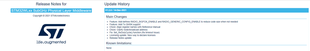

Hi @Domagoj Tomić,
You can find the main changes for STM32cubeWL v.1.2.0 in the STM32CubeWL for the MCU package: “Repository\STM32Cube_FW_WL_V1.2.0\release_notes.html�?.
Also, you can show the main changes for SubGHz_Phy in the below figure or in this path "\Repository\STM32Cube_FW_WL_V1.2.0\Middlewares\Third_Party\SubGHz_Phy\release_notes.html".
Thank you.
Kaouthar

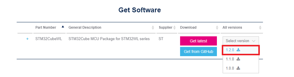

Hi @Domagoj Tomić,
You can download the STM32CubeWL v1.2.0 form STM32CubeMX or from the ST web site (as shown in the below figure).
Kaouthar

2022-10-18 2:55 AM
Hi @Domagoj Tomić,
Thank you.
