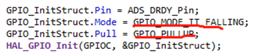

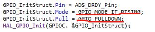

STM32WB55RGV6 GPIO pin configuration ADS_DRDY_Pin is PC11. When I change GPIO_MODE_IT_RISING to GPIO _MODE_IT_FALLING, my ble server can not work normally. Rising is ok, but I can't find my ble device(in falling).

0693W00000SwBb6QAF.png0693W00000SwBbBQAV.pngADS_DRDY_Pin is PC11. When I change GPIO_MODE_IT_RISING to GPIO _MODE_IT_FALLING, my ble server can not work normally. Rising is ok, but I can't find my ble device(in falling). Thank in advance.

Also, why have you changed the pull-down to pull-up?

It's no pull, the picture is wrong.
When I use raising edge external interruption, all is well.
When I use falling edge external interruption, the led can toggle, but I can't find my BLE device (BLE can't work). Can I think the cause of my problem is on the bluetooth side?

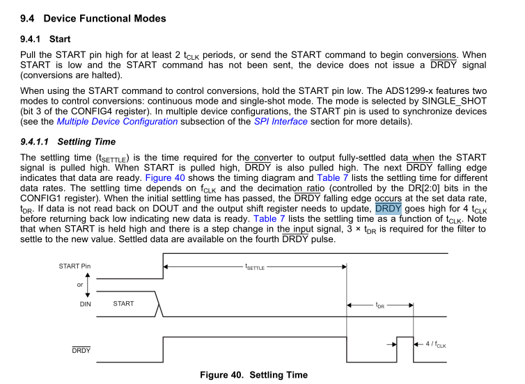

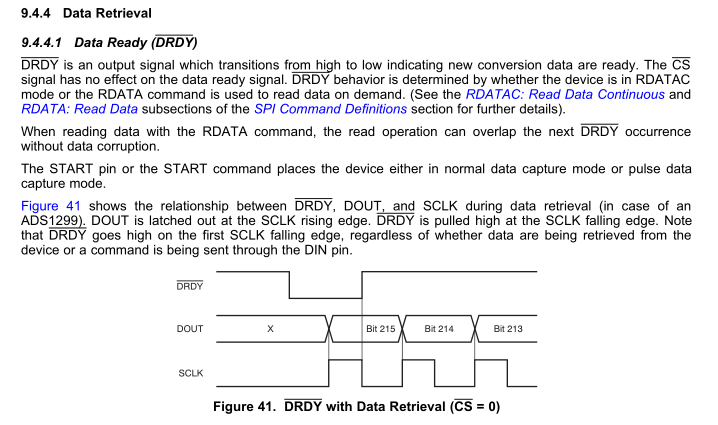

The ADS_DRDY signal are as follows(ads1299 datasheet):0693W00000SwDdOQAV.png0693W00000SwDeCQAV.png
OK, I still don't see how the DRDY interrupt is tied with the BLE. Are you waiting on some data, or just for start of the ADS? The led is toggled in the interrupt, or in the main code?

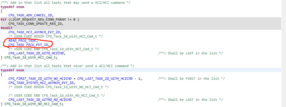

I speculate that it may be the scheduler, even if the task to be executed is an empty function(P2PS_Send_Notification_Task_FECG).Actually the scheduler will execute this function.
UTIL_SEQ_SetTask( 1<<CFG_TASK_FECG_EVT_ID,CFG_SCH_PRIO_0);
Is it possible that the scheduler polling will generate an error because I use falling edge?
The ADS_DRDY signal (data ready signal) can be judged by the external edge interrupt method(HAL_GPIO_EXTI_CALLBACK) and reading the state of this pin(HAL_GPIO_ReadPin(ADS_DRDY_GPIO_Port, ADS_DRDY_Pin)).
For the second readpin method, how should I write the program?
Currently I only know about external trigger (HAL_GPIO_EXTI_CALLBACK) and virtual timer (HW_TS_Start), but I don't know how to read the AS_DRDY pin state and send notification program in the task scheduler (I don't think the above two methods are applicable).0693W00000SwKMeQAN.png
