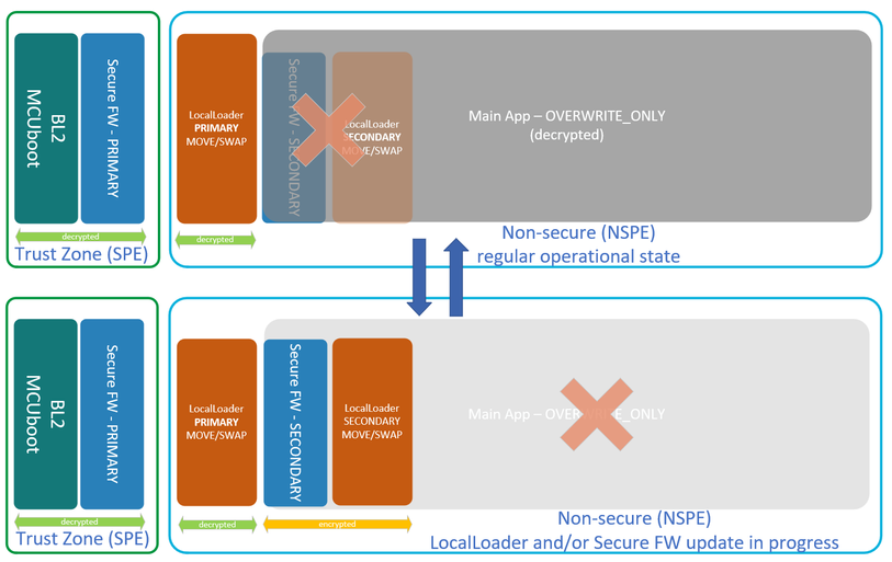

What I need to implement is a very typical real-live scenario - a device (let's imagine it is a fancy coffee machine) based on STM32U5G9 MCU which will be periodically updated by a qualified service technician from USB stick (Y-modem etc. is not considered a modern/convenient hence acceptable solution). Therefore, only the boot loader and the USB Local Loader apps require 100% secure updates (two slots) since any update failure would brick the device. As long as Local Loader is healthy, failure to update the Main App is not a problem, another attempt, e.g. using another USB stick can be easily made.
On the contrary, the Main App, which will be loaded from USB stick by Local Loader and updated the most frequently, does not require primary/secondary slot since the ability to utilize the maximize remaining flash area is way more important.
Needless to say, the Main App image has to be encrypted and signed thus Local Loader needs to be able to verify the signature of the firmware image temporarily placed in SRAM and decrypt it. I do not mind if Secure FW or Local Loader update wipes out the Main App - probably it will have to be updated anyway. Likely Main App image will have to be compressed before it is encrypted and delivered and then decrypted because otherwise it may not fit into available SRAM, unless decryption is done on-the-fly but this is less of the problem.

@Jocelyn RICARD Just one more comment. For my current project I will proceed with TrustedFirmware-M (TF-M) solution, despite its folder structure is a nightmare. It took me several days but I just got it working with STM32U5A9, with gtzc config commented out for now all tests pass. On reason for this choice is strategic: it is difficult to see SBSFU future in bright colors. Another one is technical: I prefer to have MCUboot as a separate image and the rest of the secure firmware updatable.

Hi @Jocelyn RICARD, Unless I am missing something, SBSFU consists of two applications: secure and non-secure. At least this is what docs state all over the place. Only two images: bootloader combined with secure services running in trust-zone and the main non-secure user application.
By default, TrustedFirmware-M (TF-M) uses 3 images: MCUboot (BL2) which is NOT updatable (at least not easily), updatable secure services image (runs in TZ) and the main non-secure application image. Needless to say, ability to update secure services is a very nice feature. Ofc, I may never need it but if I do and it is not an option the product has a problem. It is all about risk mitigation (e.g. currently unknown vulnerabilities) and flexibility to add new features hard to foresee initially. The product hopefully will live for many years and will continue receiving software updates.
Since my first user application (local loader) needs to be able to at least verify signature of the image it downloads in order to early report new firmware problem to the user, I need TF-M secure services very much. Otherwise, I would have to use (and store) another set of keys etc. in non-trust zone. This simply is not an option.

Secure TF-M app I need exactly to be (e.g.) able to verify downloaded image signature from unsecure app without access to secure keys which, of course, cannot be exposed to unsecure app. Ability to handle scenarios like the one I described, best to my knowledge, is the very reason why countless hours have been spent to build TF-M solution, although it takes extra flash space and it is not just several kB. This is the area where SBSFU clearly falls short.
SBSFU solution deserves credit for being much easier to grasp, but TrustedFirmware-M (TF-M) has the functionality I need. Actually, way more than I need which, as you rightly pointed out, does not come free. ST's TFM solution was probably intended to bridge this gap. Too bad it appears to be abandoned.
