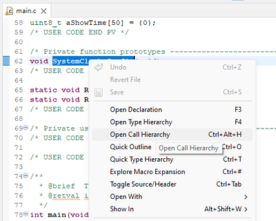

@Tesla DeLorean wrote:Within your chosen IDE, look at the Right-Click type context options to follow code, calls, definitions, etc,
+1

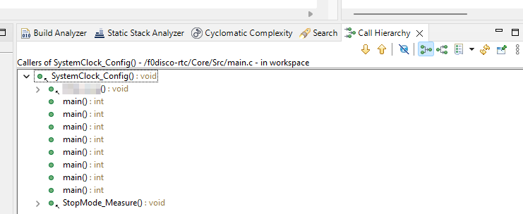

@ABA eg, in STM32CubeIDE there's the Call Hierarchy:
This gives you a "tree" view of where the selected function is called:
These buttons
Let you switch the view between callers and callees
