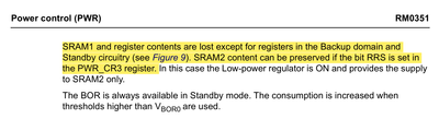

In sleep mode, data is kept. Should be straightforward doing this.
In standby mode, SRAM data is lost but you can adjust your program to keep SRAM2 and store data there between resets. You'll have to ensure it is not initialized on startup.
