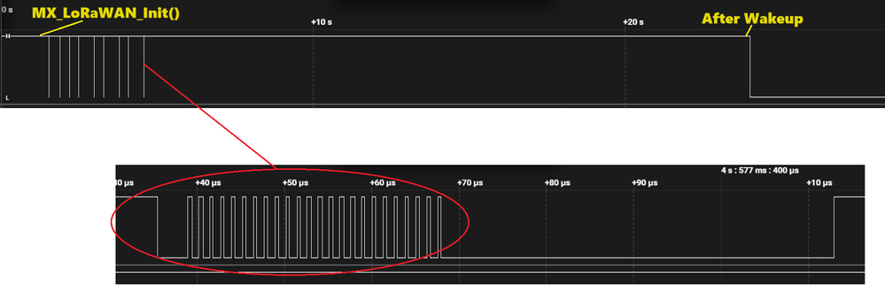

Hello Everyone, I'm driving the WS2812 RGB-LED using TIM16 CH1.
I have a very similar behavior as in this_post . The RGB works well just until MX_LoRaWAN_Process(void) then it doesn't work. I tried his solution but it didn't work(although I suspect the SYSTICK is not working).
The Waveform looks like this:

Hello @AElgh
Are you disabling the Timer clock before entering the STOP Mode. If so, try to keep it enabled.
Best Regards.
