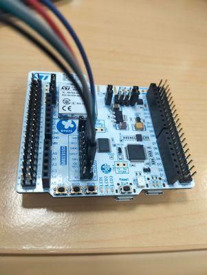

Hello @GS2
To program your STM32WB5MMG Module using a NUCLEO-WB55RG, you have to take of all connectors available on the JP5 of the NUCLEO board and connect the pins from the JP5 to the pins of the STM32WB5MMG module as follow:
| STM32WB5MMG module | JP5 of the NUCLEO-WB55RG |
| VDD | T_VDD |
| PB3 | SWO |
| PA14 | SWCLK |
| PA13 | SWDIO |
| NRST | NRST |
PS: use the pins of the JP5 on your right hand for the NUCLEO board.
Best Regards.
