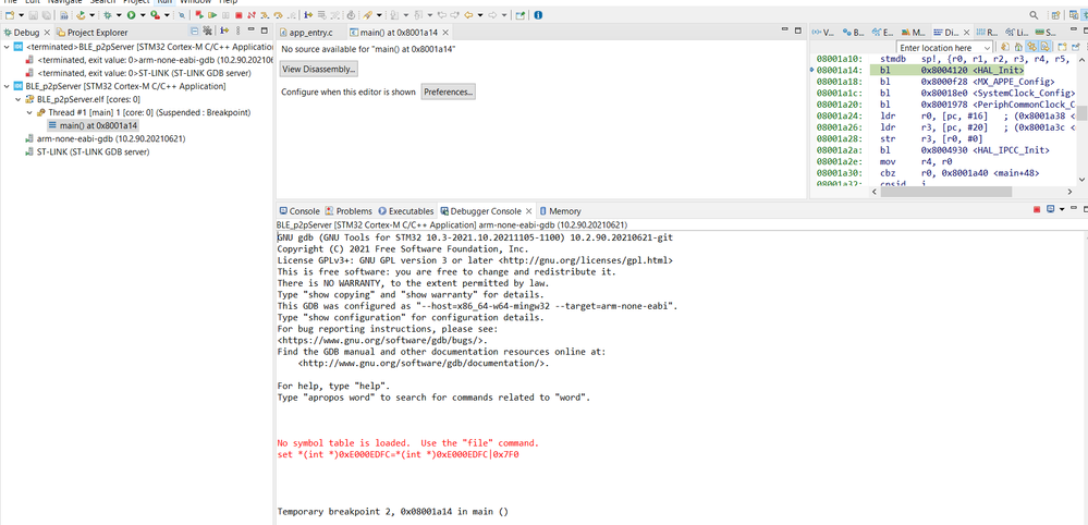

I am trying to debug a sample project from st website and but it is stuck in the first line of main (assembly ) meanwhile when I flash the .hex with cube programmer , the project works perfectly. So I assume that it's a problem with the debugger.
I made sure that he's selecting the correct .elf file but still not working
I did respect all the readme steps.

Not really clear on the part or the context, or errors it had when starting the debugger.
Looks like it can't associate source files, so perhaps wrong meta-data in .ELF file.
Is it a part with multi-cores, or some kind of loader application in the front of the Flash?
