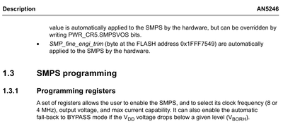

From the datasheet:
and the reference it points to goes into detail on how to use SMPS or set it to bypass.

Thank you. I found that there is this define in app_config.h:
* SMPS supply
* SMPS not used when Set to 0
* SMPS used when Set to 1
#define CFG_USE_SMPS 1
to activate the SMPS
