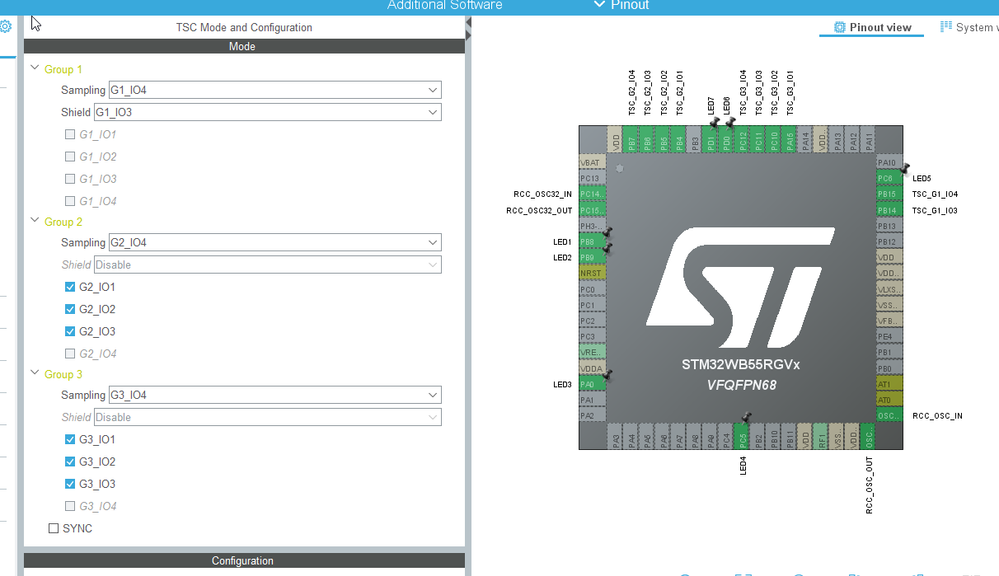

The Sensor Capacitor (Cx) is not connected in the below mentioned. Can you please provide clarity on the Cx connection with MCU.
Please find the STM32CubeMx image regarding 1st point.

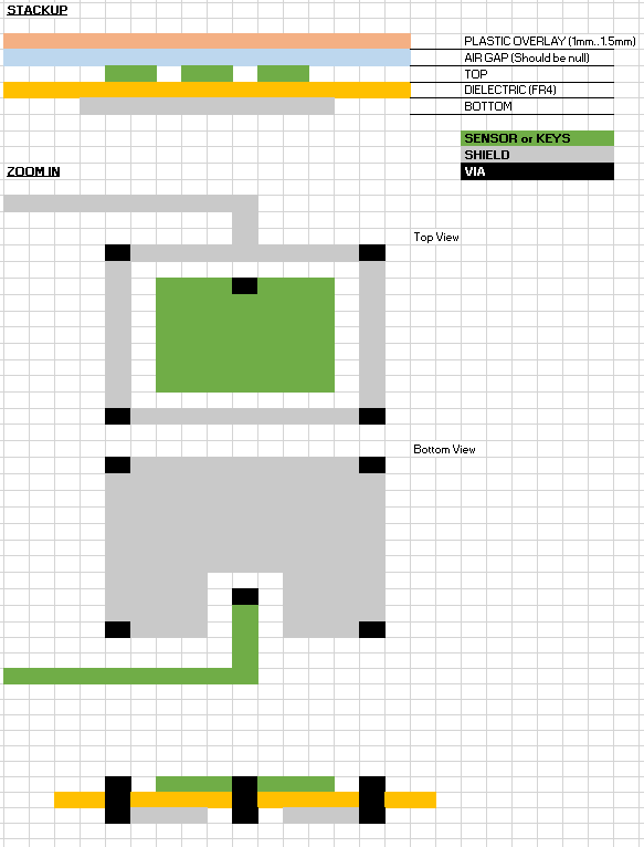

2019-07-22 7:48 AM
Find an example based on 6 sensors + shield
A) Regarding the STM32CubeMx project:
B) Regarding schematics:
C) Regarding application
ioc, main.c and interrupt files are attached.

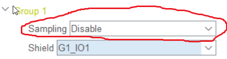

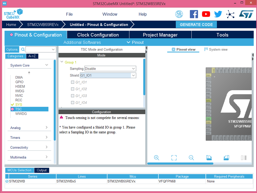

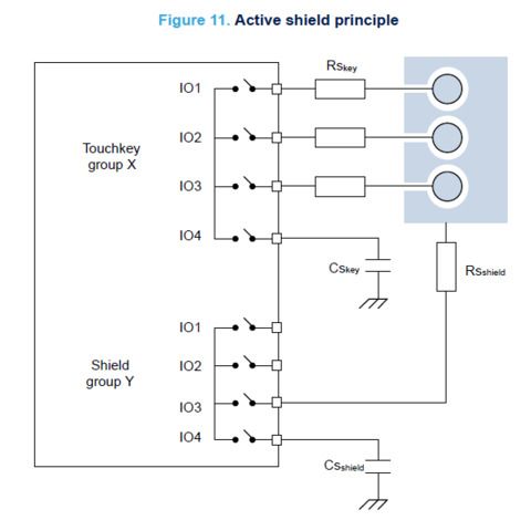

2019-07-22 7:17 AM
Regarding 1, you just need to select an IO for Sampling capacitor.
Regarding 2, No Rshield is between the Shield IO (G1_IO1 in your case) and the copper shield.

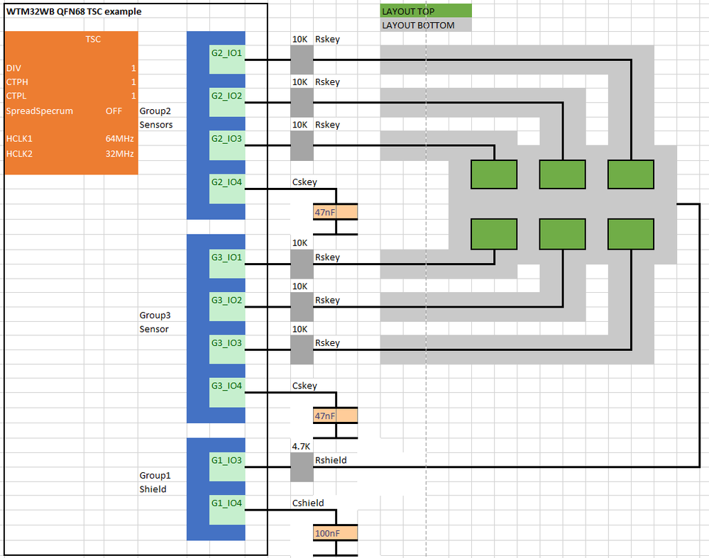

2019-07-23 12:30 AM
Find a schematics bellow from layout point of view:
