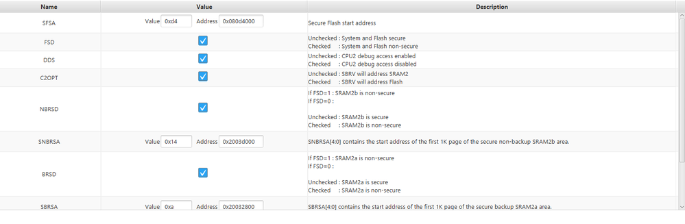

Following is OB info attached. Cube programmer version I am using is : v2.9.0
What could be the issue, please let me know how to resolve FUS and start wireless stack successfully ?

2022-03-09 8:28 AM
Sorry about that, here it is:

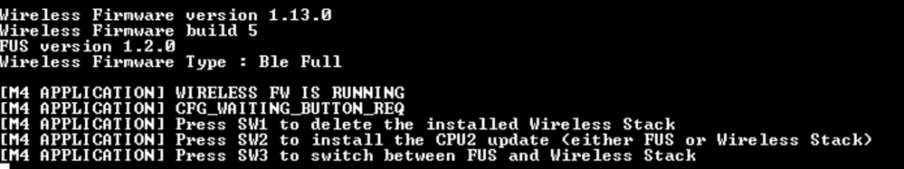

Load this diagnostic binary in M4 which display Wireless Stack and FUS version on debug trace and allow to perform some action:
In your case, FUS is running, so try to delete the installed Wireless Stack and then with STM32CubeProgrammer install the stack with address indicated in release notes.

2022-03-10 8:08 AM
You can flash the binary via STM32CubeProgrammer in "Erasing and Programming" window at 0x08000000. When it's done, if you are able to connect your board to a HyperTerminal (TeraTerm for example), you have some logs which displayed FUS and Wireless Stack version like this:
You can also see if the FUS is runnning or if WS is running.
Others solution with STM32CubeProgrammer, try to delete Wireless Stack with "Firmware Delete" button.

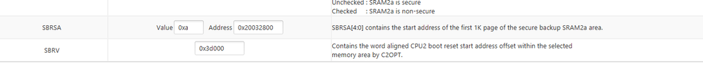

2023-05-11 7:04 AM
Just missing the ESE and SBRV value.

2023-05-11 7:12 AM
According to your screenshot, SBRV is equal to 0x3D800 that indicate FUS v0.5.3 is running on your board. So, you must update the FUS using the stm32wb5x_FUS_fw_for_fus_0_5_3.bin binary.
Best Regards
2023-05-11 7:17 AM
oups I did not see the small window below :) for the SBRV value.
