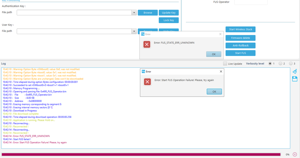

I am using the STM32WB55RG MCU, Bluetooth feature with stack version 1.13.0 and FUS version 1.2.0. Everything was working normal until I tried doing the firmware upgrade of stack from v12.0 to v13.0. I am not able to perform FUS related operations. The version reading shows 0.0.0 for FUS. And following is the log when I hit "Start FUS"
11:09:47 : Warning: Option Byte: nSWboot0, value: 0x0, was not modified.
11:09:47 : Warning: Option Byte: nboot0, value: 0x1, was not modified.
11:09:47 : Warning: Option Byte: nboot1, value: 0x1, was not modified.
11:09:47 : Warning: Option Bytes are unchanged, Data won't be downloaded
11:09:47 : Succeeded to set nSWboot0=0 nboot1=1 nboot0=1
11:09:47 : Memory Programming ...
11:09:47 : Opening and parsing file: 0x495_FUS_Operator.bin
11:09:47 : File : 0x495_FUS_Operator.bin
11:09:47 : Size : 8 KBytes
11:09:47 : Address : 0x08000000
11:09:47 : Erasing memory corresponding to segment 0:
11:09:47 : Erasing internal memory sectors [0 1]
11:09:47 : Download in Progress:
11:09:47 : File download complete
11:09:47 : Time elapsed during download operation: 00:00:00.272
11:09:47 : Application is running, Please Hold on...
11:09:47 : Reconnecting...
11:09:47 : Reconnected !
11:09:51 : Reconnecting...
11:09:51 : Reconnected !
11:09:51 : Error: FUS_STATE_ERR_UNKNOWN
11:09:51 : Start FUS failed !
11:09:51 : Error: Start FUS Operation Failure! Please, try again
Following is OB info attached. Cube programmer version I am using is : v2.9.0
What could be the issue, please let me know how to resolve FUS and start wireless stack successfully ?

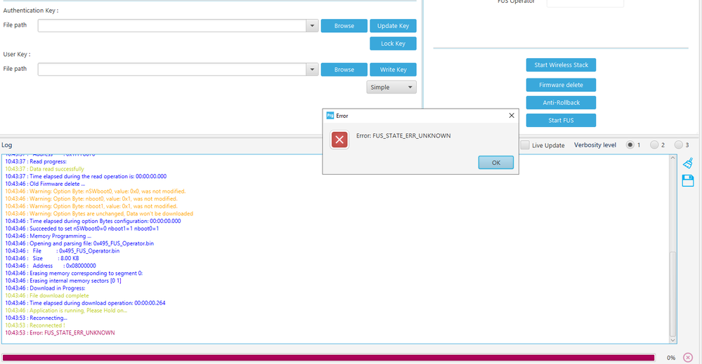

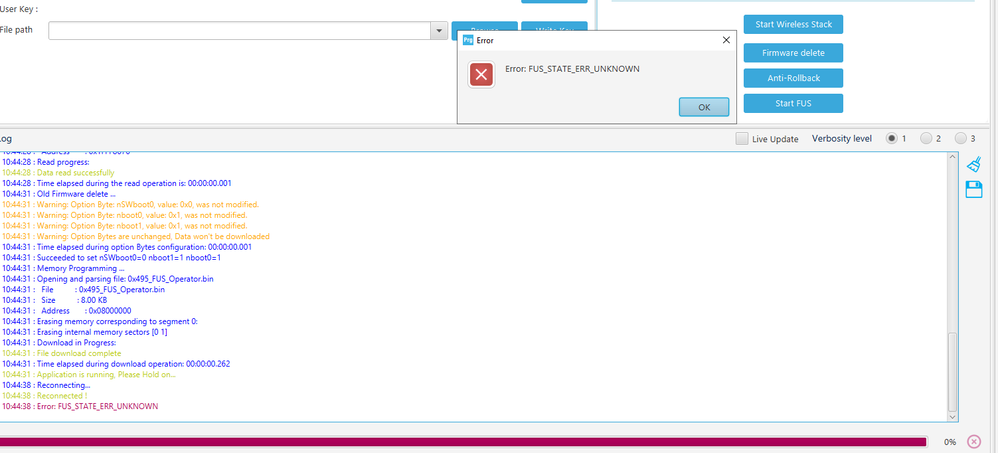

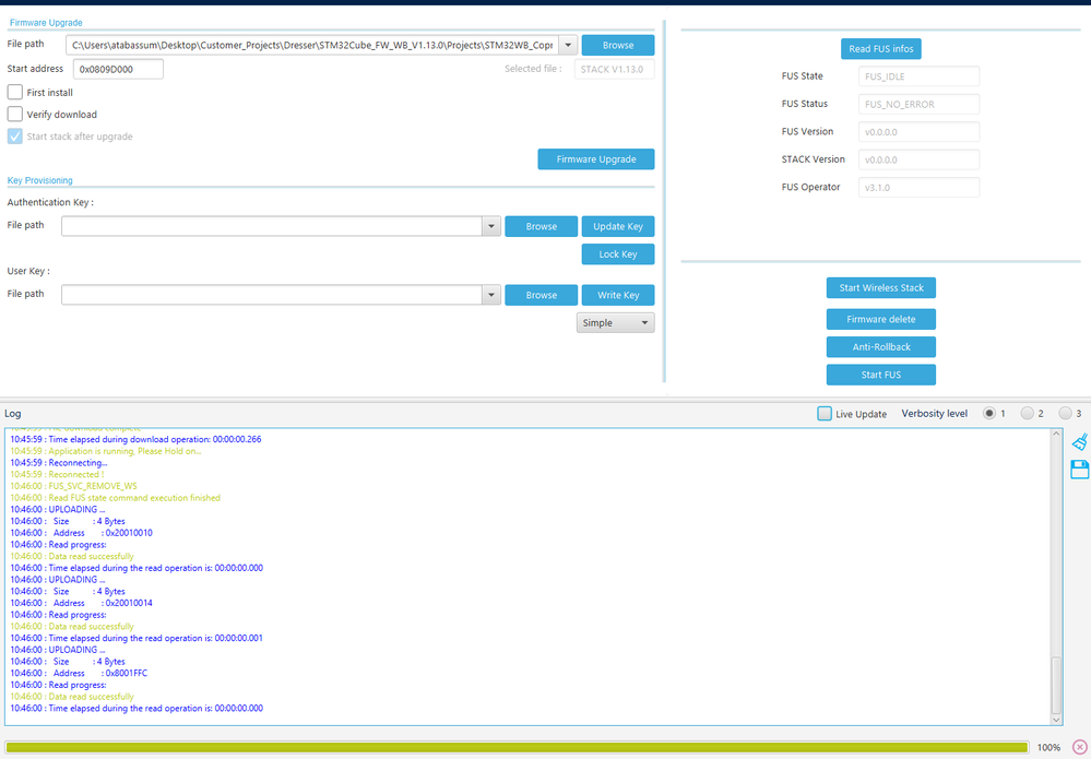

2022-03-09 7:46 AM
No, I am not able to do anything.
2. Upgrade FUS shows:
3.Upgrade wireless stack shows:
And when these errors occur, if I read FUS info after these I see the following:

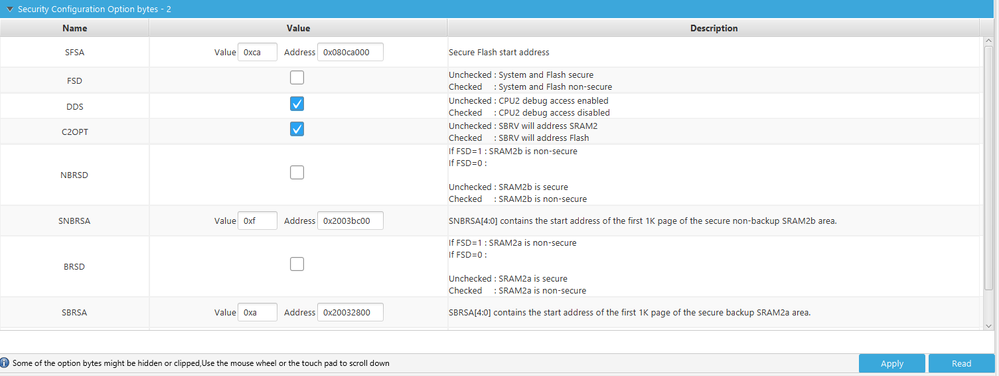

2022-03-09 8:10 AM
Could you take a screenshot of Security Configuration Option Bytes - 2 ?
Best Regards
2022-03-09 8:12 AM
Sure, following is the screenshot:
2022-03-09 8:27 AM
Miss SBRV option byte
