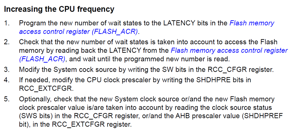

Can't see what's in rcc_reset from here.
Did you follow the RM notes on increasing CPU frequency? Namely wait states.
Are you following the guidelines for modifying MSIRANGE? Modifying the register in a single operation rather than twice in a row is a better idea.

> I should be following the guidelines stated there.
But are you? Where do you modify wait states?
> RCC->CR &= ~(RCC_CR_MSIRANGE);
> RCC->CR |= RCC_MSI_CLOCK_SPEED_32MHz << RCC_CR_MSIRANGE_Pos;
How do you know MSI is ready between those two statements? You certainly aren't checking in the code.

Fair enough.
I added in the MSI ready check and set the wait state to 2 and the firmware runs perfectly fine now
