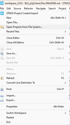

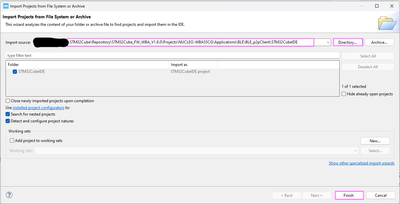

Hello @kclauah ;
Could you please try to click at "Open Projects from File System" to open the example
Then, choose the "Directory"
If you want to generate code from .ioc file using STM32CubeMX toolchain, I recommend you to copy the .ioc file in a new workspace then generate code and open the project using STM32CubeIDE
I hope this help you.
Thank you.
