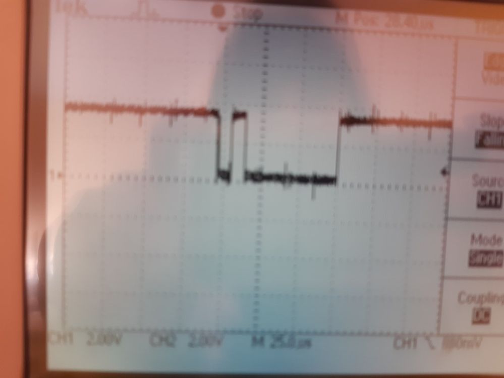

Hello I am worcking an the P-NUCLEO-WB55 and I try to communicate with a other module with the LPUART. Seeing that I didn't have any responce to my commands, I use a scope to see the TX trame.
This is for example the trame of '<' (00111100) .
I used the command HAL_UART_Transmit(&hlpuart1, '<', 1, HAL_MAX_DELAY);
And there, the LPUART parameters:

I tired to send many other caracters but I never see the good trame on the scope.
Any idea of what appened?

I think HAL_UART_Transmit needs a C string "<" not a single character '<'.

You might have some other things wrong, but when you call
what the library-function is expecting is of the form
HAL_StatusTypeDef HAL_UART_Transmit(UART_HandleTypeDef *huart, uint8_t *pData, uint16_t Size, uint32_t Timeout);
So you are giving '<' to the pointer-to-string variable pData.
What does the C compiler do under these circumstances?
It gets the ascii value of the character '<', in this case 0b00111100 or 0x3c
And passes that as the address for where to find the (in your case one-character) string.
And then the library-function then sends whatever happens to be in memory location 0x3c. Not the value 0x3c.
If instead you did
HAL_UART_Transmit(&hlpuart1, "<", 1, HAL_MAX_DELAY);
The C compiler would create a C string consisting of your character '<' and the string-terminator '\0' and store it in program memory. It would pass the address of that string to HAL_UART_Transmit(). And the library-function would look in the memory-location specified by the address, and retrieve the character '<' and send it.
2020-02-06 4:23 AM
@Danish is correct: you are sending over UART what's at 0x0000003c address, not the actual '<' character.
