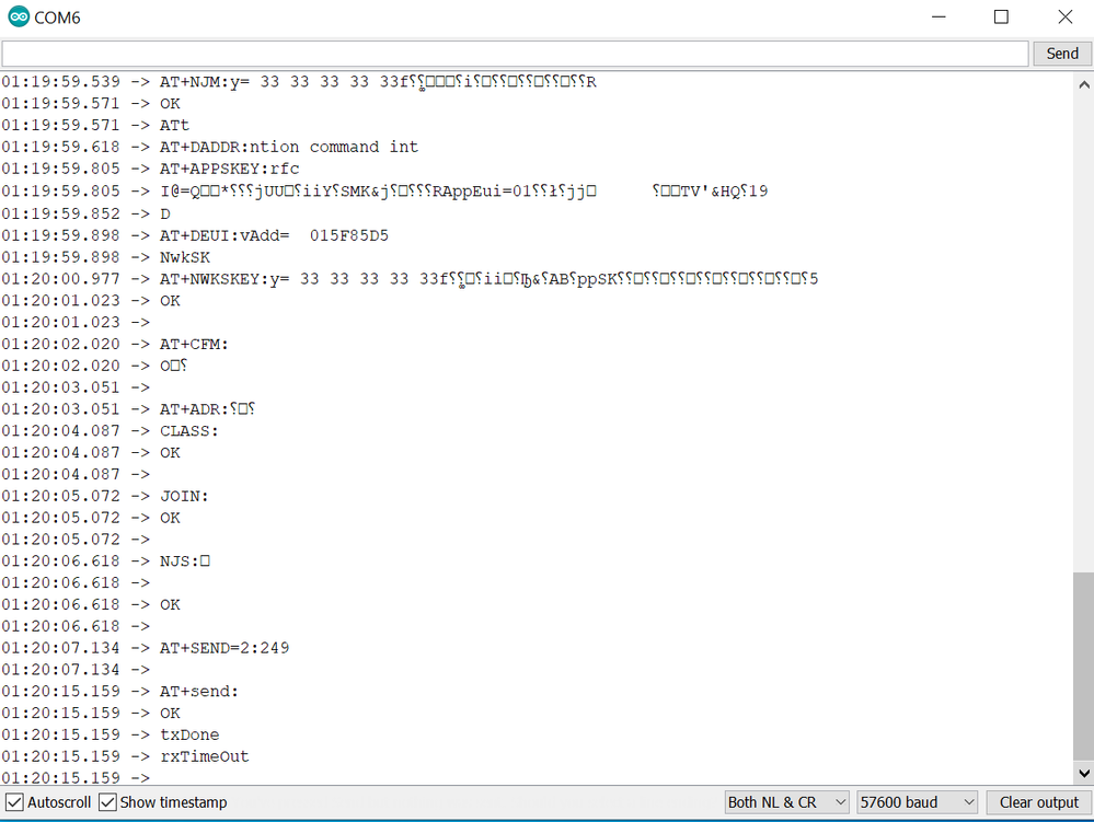

2020-02-05 1:56 PM
we are not Getting non readable value from module also it's not sending to gateway but same cmd working with dock light

2020-02-05 3:00 PM
>>I'm Using stm32 based Lora Module...
Not sure that's terribly specific. Does it have a part number, perhaps a website?
Does it have a manual?
If you connect it more directly to a terminal, can you walk it through the command sequence successfully with that?
