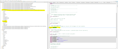

2024-09-08 11:48 PM
Ok I have added all the screenshots step by step
1. I-NUCLEO-LRWAN1 file.
2. Project Workspace-> main.c file, in the while loop I am calling Lora_SendData() function with the parameter as structure data containing buffer and the port.
3. This function calls Modem_AT_Cmd() function that takes structure and AT command as the parameter value.
4. This calls AT_Cmd_format() function which makes the AT string and stores it in the AT command buffer.
5. The Modem_AT_Cmd() function calls at_cmd_send() function which again calls HAL_UART_Transmit() which finally transmit the data stored in the huart2 TDR register.
I have attached the screenshot sequentially in the order functions have been called.

Can you please share the code of your project and the output you get as you run the project that will help me in debugging the error if possible can you please add the screenshot.
2024-09-09 5:59 AM
On my side, that works really fine. You just have to go to the Sys_conf.h file and enable the debug by setting the DEBUGGER_ON MACRO to "1":
