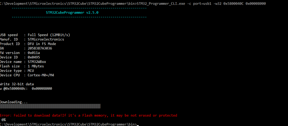

How ti correct write data to address ?
I use:
STM32_Programmer_CLI.exe -c port=usb1 -w32 0x5800040C 0x00008000
but get error:
2020-08-27 2:51 AM
Could you download all the sections of the options bytes or call the command STM32_Programmer_CLI.exe -c port=usb1 -ob displ and give me the log?

Ok nothing wrong regarding the option bytes except this puzzling ESE set to 0.
Regarding the marking, I would be interested in the one on the failed chip.
I'll come back to you with information on the one above.
