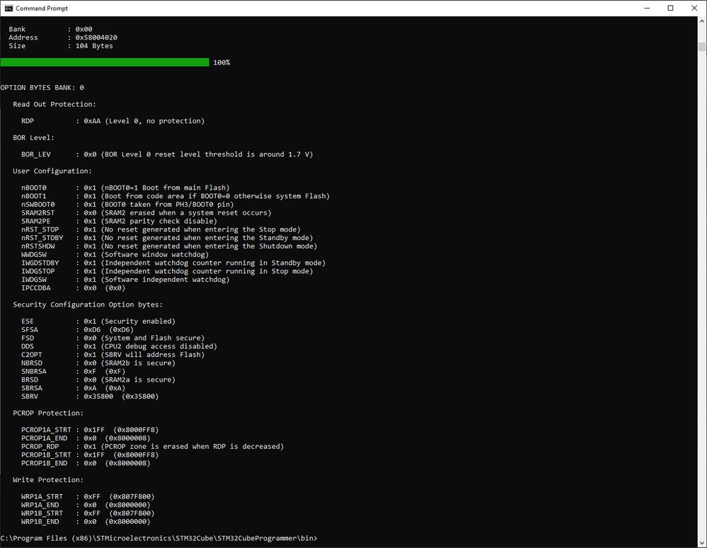

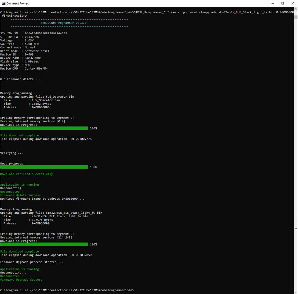

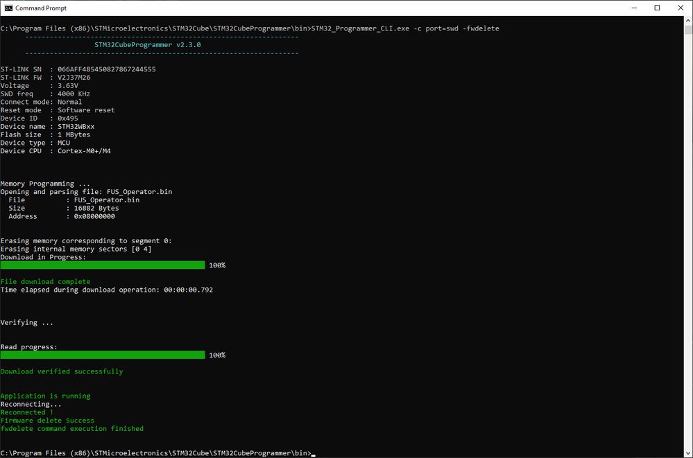

Done. Loaded stm32wb5x_BLE_Stack_light_fw.bin (en.stm32cubewb_v1-8-0.zip) with the set-up I'm using and all went fine. See traces and -op below, compare to what you have and have a go at it again. Good luck
STM32_Programmer_CLI.exe -c port=swd -fwdelete
STM32_Programmer_CLI.exe -c port=swd -fwupgrade stm32wb5x_BLE_Stack_light_fw.bin 0x080D6000 firstinstall=0
STM32_Programmer_CLI.exe -c port=swd -ob displ
