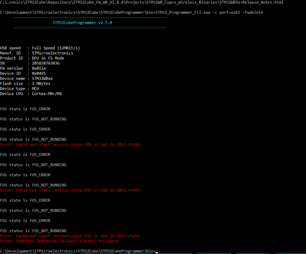

Using STM32CubeProgrammer I load last stm32wb5x_BLE_Stack_light_fw.bin, but when after that I try to run command -fwdelete, I get an error : "FUS_NOT_RUNNING".
I attach log file becose Idont understand whot is this.
But me application work fine and I see that stack is a last version.
Please help whot may bee .
I send call:
STM32_Programmer_CLI.exe -c port=usb1 -fwdelete -vb 3

First try to delete:
