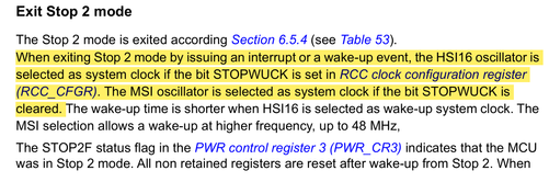

>  I would like to ask how I can switch to the HSI clock after waking up, and then, of course, switch back to the LSE to allow wake-up functionality.
After exiting Stop 2 mode, the clock is either already on HSI or MSI depending on settings.
To switch from those to LSE, configure LSE as the system clock using HAL_RCC_OscConfig same as you do if you select it during startup.
